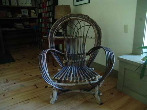

to try. Anybody tried birch? I cut and split a lot of firewood as well and found
that birch really absorbs moisture, maybe not a desirable thing. Some older
Swedish Goya guitars were made with birch back & sides, maybe not the
same species as we find here, mostly white and yellow birch. Birch really
bends well when green though and makes terrific rustic furniture.
